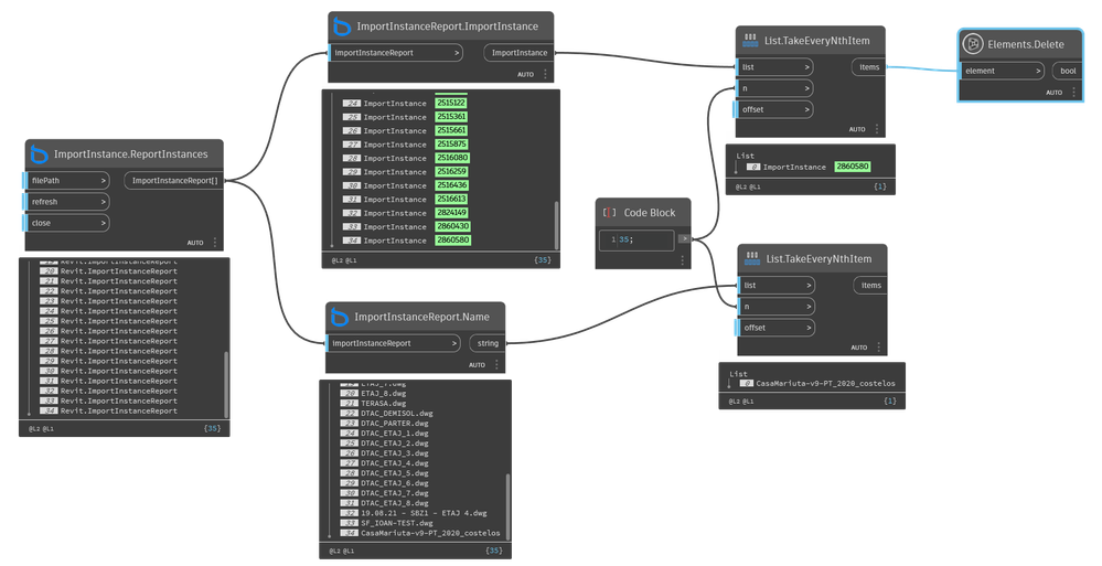

you can Delete CAD imports directly from Dynamo...
if you work in  Revit 2023 ,then:
if you work in a previous version:
Constantin Stroescu

...or, if you want to select only one or several imported items to delete , then use this:
Constantin Stroescu
