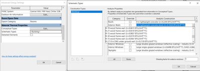

It is likely staring me right in the face, but I cannot figure out how to add fiberglass batt insulation to a wall assembly. Everything I have seen so far shows the insulation as a layer like a foam board as opposed to a detail between the studs.
I also would like to know how loose-fill attic floor insulation is modeled, I am having the same issue with that.
Is there anywhere I can go to find more information on how to do this properly?

I was thinking more about it from an energy modeling standpoint. I am still trying to work through running my first model, but apparently I have a fundamental misunderstanding of how the system calculates those factors.
It seemed logical that you could spec out a wall assembly with batts or spray foam and then that would be factored into the energy model.
How is the correct way to handle energy modeling with different insulation systems like Batts or loose fill in the attic?

Yes. I am looking for the place to specify the insulation configuration for thermal analysis.

It has nothing to do for thermal analysis.  You need to look into Analyze > Energy Settings . Conceptual Types and/or Schematic Types.

You wouldn't even need to go that far.  You can just use Schematic Types.

I know this is a few years late for you, BUT, you can add thermal values to materials in the assembly.
So, if you want R20 Batt insulation and 6.2 exterior rigid, add thermal properties to the stud material (if thermal tab is missing, use the plus symbol, if existing relink), after selecting the appropriate material and doing the same for the exterior rigid, adjust thermal conductivity on each to specific values if not typical. The Assembly, (wall/floor/ect.) will then show the R-Value in the type properties dialogue box.
