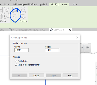

Extra question, is there a way to expand the view wider (rat view). automatically, says 10ft both sides.
I have to do that for every camera view, perhaps 2022 has that option.
Nachricht 7 von 9
als Antwort auf: yes_and_no
@yes_and_no wrote:
It works. Thx guys.
Not that I know of.  But you can Zoom out the camera view smaller than your view screen, select the view crop, right click and choose Reset Crop Boundary to Screen, then the view will fill your screen.
Or, manually grip resize the Crop.
Or manually type in Size Crop value.

Thx, Toan. This must be a good place for Macros ?
Nachricht 9 von 9

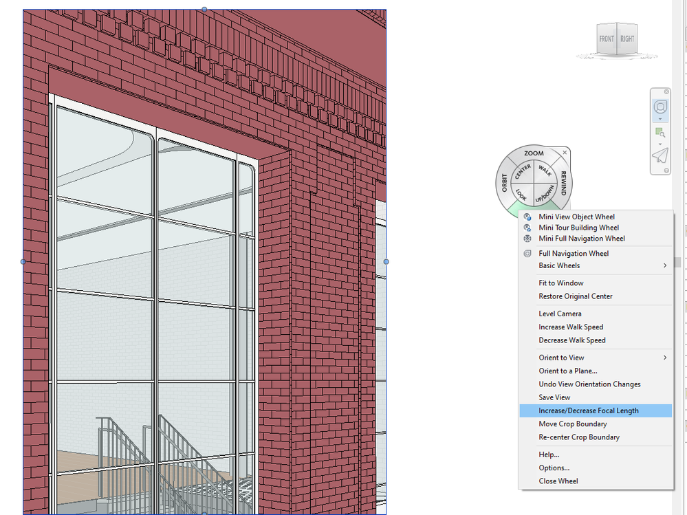

I know nothing about Macros.  But you can also do this:
