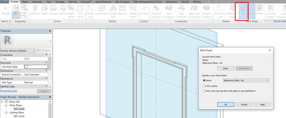

@barthbradleyidea is the way to go. However if you do want to control which surface you want it to draw, you can also create a reference plane and give it name.
Go to 3d and click on SHOW reference plane. Then click on SET and pick your named reference plane
Then you can draw whatever profile.
