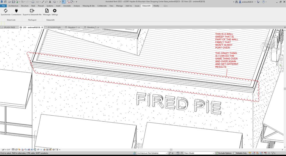

Wall sweeps will sometimes disappearing when porting the datasmith file over to Twinmotion 2022.2.3.
My tesselation levels are set to 8. I am going to try to export to FBX to see if the issue still occurs. Has anyone else ran into this issue here. Is the fix on the Revit side or on the Datasmith side? I tried my visibility setting adjustments. This project does have phasing an existing and new. And the intention is to show new only so they are on that phase "new"
Autodesk Revit 2022 - [x22097 Hayden & Mountain View Shopping Center Base_andrew8QEC8 - 3D View_ {3D - andrew8QEC8}] 1_27_2023 11_29_14 AM.jpgTwinmotion 1_27_2023 11_29_49 AM.jpg

Create Parts from the wall sweeps, set the 3D view to Show Parts, and export.

This works. Thank you!
