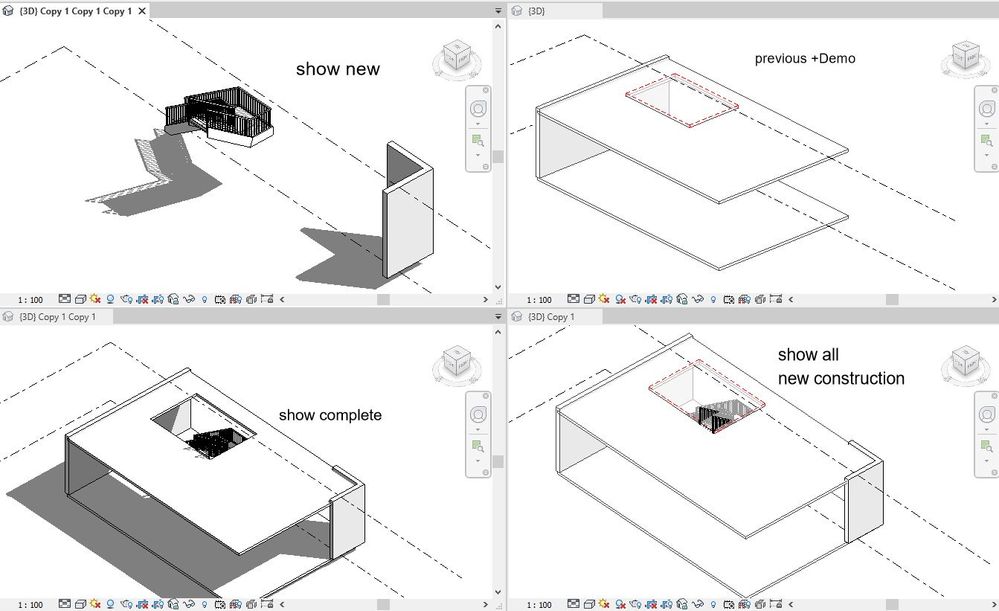

For reference, we are using Revit 2019. We have an extension job that requires new stairs to go from the garage to the ground floor. I have used an in place void to cut out the existing floor to make way for the new stairs. This makes the cut, but when my view is set to show the existing phase, the new phase and also the demolition phase, i cannot see my stairs from the ground floor plan. the cut piece of floor is hiding the stair. I changed my phase filter to show the Demo phase only but i cant find the demolished piece of floor to make it transparent. If i change my phase filter to show New and Previous phases, the stairs will show. I am pretty sure this is a Revit 2019 issue as i have cut floors this way for years and never had a problem. Has anyone else had this problem?  any ideas?? I have done the latest update for revit and this issue is still there.

with the view set to show new and demo, i would expect to see the new stairs and the piece of floor that is being cut out but only show the new stairs and the cut floor without a demo piece of floor. I have attached an image showing the piece of floor that is being cut out. This view phase filter is set to show new, previous and demo phase.

I have modeled the inplace void to match the outline of the stair, in the new construction phase and made the cut in the new phase. i have attached an image showing the same format as your previous image

Im not telling the void to be demolished. I am just drawing the void where i want it to cut out of the existing element and then telling the Void to cut the existing element as shown below using a roof for example, shows me the demolished piece of roofing. i hadnt really though about doing it your way Ganesh but it makes sense and works well. Much appreciated . To address the transparency of the demolished object, when something goes to a demolished layer, it can often hide other things such as flooring hatches, plumbing items etc so we override any demolished item to be transparent in each view separately. As per the view below showing the demolished roofing, i would select that piece of roof in an elevation and make it transparent using the override by element so that it doesnt hide any of my new structure for that project. Existing Roof - using a void to cut a portion out part 1.JPGExisting Roof - using a void to cut a portion out part 2.JPG

Here is a 2019 test file.  It still works.  Use Unjoin geometry and click on the original floor to separate the non-demo and demo portions, then you will be able to select the demolished portion of the floor to graphics override it.
With that said, @Corsten.Au approach is a more common way to do it.
Nachricht 17 von 17
als Antwort auf: ToanDN
Thanks ToanDN
The Unjoin tool did exactly what i am after!! but i think your right in that @ganesh approach is a more user friendly and probably a better approach to deal with the cut. Turns out some of my other colleagues use @ganesh  approach in it works well for them. I dont like to edit the existing model in anyway which why is why i use voids as they leave the model exactly as it was once you delete the void but i think i will be changing my mindset slightly for dealing with floors and potentially other elements.
