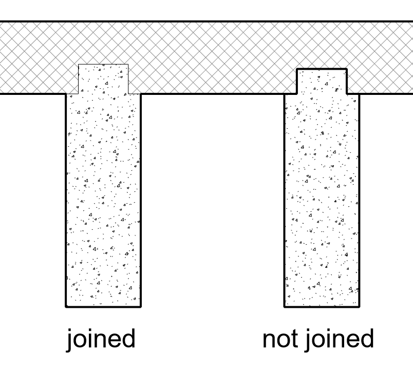

Corsten.Au
als Antwort auf: jagostinho74
This should help you.
Corsten
Building Designer
Nachricht 10 von 12
Are the two wall not joined?  it works fine here.
Scratch that.  Works either way.
Nachricht 11 von 12
MostafaElashmawy
ah it's clear now.
the cut profile is done.
but the two wall must be joined to work correctly.
Mostafa Elashmawy
Nachricht 12 von 12
jagostinho74
Thank you all.
For some reason I cannot join the walls together. Checked this list but nothing applies.
Still cannot get it to work. I have attached the RVT I used to test it.
