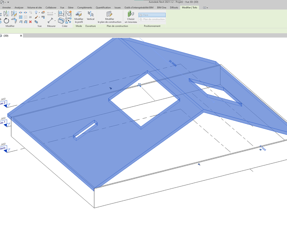

Select your roof and look in the upper ribbon, there is an icon vertical cut.
