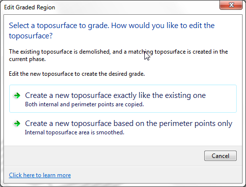

I have a split surface that will not report cut/fill no matter what I do. I have tried starting a new file, and went through this process:
1. Create surface in Existing Phase
2. Split surface in Existing Phase
3. Grade split surface in New Phase by creating exact copy
4. Edit interior points BEFORE finishing the graded surface
Cut/Fill does not report
or 4. Edit surface AFTER finishing the graded surface
This process seems to have worked for others, and it's not a setting in my file, because I tried it with a blank file, too. I've attached the file here. The only topo that matters here is the area around the house where you see survey data. Please help.

Sounds like you missed a vital step.  Did you do this?
...so, what you want to do is Split Surface in Existing and then use Edit Graded Region to send a copy of it to the next sequential phase. Now you have 2 Topsurfaces:  the Source in the Existing Phase (Phase Demolished will automatically be set the the following Phase),  and the Copy in the following Phase (Phase Demolished will automatically be set to "None"). Now when you edit the Copy, it will report Cut/Fill, based on how the copied Toposurface varies from the Source Toposurface in the Existing Phase.
TIP: Give the Source and Copy unique identifiers (e.g. different Marks or Comments).

Yes, that's how I made the Graded Region in the first place. I used the graded region tool to demolish the existing topography and create a new one that was identical. It doesn't work.

It's all wrong in the file you returned.  That little split area of earth at the house is reporting cut/fill, but has no source.  Merge that Split Surface with the surrounding Topo, and start all over using the workflow I described.
...Examining your file and I think I know where you may have errored.  The large land masses are all existing, so they should all be in the Existing Phase.  What you should have done is Split that Surface in Existing to make that separate Topo around the house, and then use Graded Region only on that Split Surface.  Nothing else is effected.  Then in the next phase, grade that Graded Region copy that was created.

Source and Copy phases MUST BE sequential.
The workaround is to has a DEMO phase proceeding each Phase.
Attached is an exhibit I did for another member explaining the process.

Yes it is a bit of trick to get to that.  The steps you have done are the same as AKN tutorials and they are entirely correct - for the entire topo surface.  Split surfaces?  It never works, ever, at least for me.
What i did to your file is split it into two files, one with the huge existing topo, the other is the house and the split topo.  Now, the split topo has no connection to the surround topo so you can perform the steps from the tutorial, grading region, adding building pads, etc... and the Cut/Fill will report properly.  When done, you can either link the huge topo file in, or copy paste it in the existing phase like I did.
