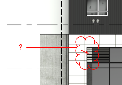

I am getting a conflict with a column and parametric louver panel.
Can I cut the panel geometry in any way?
Cut it with a solid mass form.

have you tried with Edit Profile?

so do you want to see the column or not see the column? If the column is in the way, maybe the Louver panel needs to end at the column.
