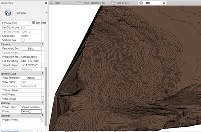

I have created a topography and have followed all the steps posted in the previous posts.
- Created topography in the existing phase
- Graded region in the New Construction phase
- Creating a pad on the graded copy of the topography in the New Construction phase.
However, I'm still seeing no values of cut and fill in the topography schedule. Tried changing the phasing views of the schedule too, but to no avail.

Thank you for your reply. I'm trying to get the cut/fill values in the topography schedule.
Here are a few screenshots.
Original topography in Existing phase
Graded region topography with building pad in the New Construction Phase
Topography schedule showing no values

Just to add more information on this in case it's helpful. I created the topography from a DXF import instance.

I don't know what's going on with your Project. I copy/pasted your Existing Phase Toposurface into a brand new Project, Created a Graded Region Copy from it in a forward Phase (New Construction) and then created a Building Pad atop the Graded Region Copy.  Worked perfectly.
