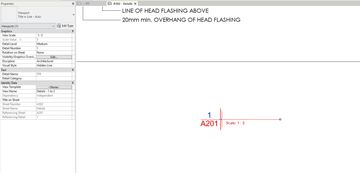

I added a manual type in View Name(Detail name) for my View Titles as the View Name sometimes is too long.
And I made 2 types: Auto & Manuel.
Auto - Show View Name & Scale as default. (Where the current issue is)
Manuel - Typed in Label made by Shared Parameter.
To switch between these two types I linked View Name Visible setting in Properties to a new parameter - Auto.
It works well in the Preview mode in the family editor. But my default View Name disappeared when I load it into my project.
Any ideas?

I have found the reason myself...
For some reason, the visibility setting did not load into the project properly. Just need to go to the family folder in the project turn the setting on haha
