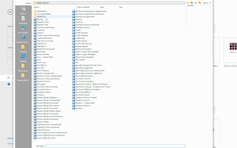

 @narsimhamurthy21   Thanks alot for the video!  While recreating it,  I found why it was not working for me !  When I was creating the Project parameters I was assigning them to other categories as well like Sheet or Views, not just Project Information and for some reason it didn`t work, did not automatically update the label. You can test that too.
@jvpantin2  Is this what you were referring to about multiple categories issue?
So I tried again and assigned them only to Project Information and it works!
