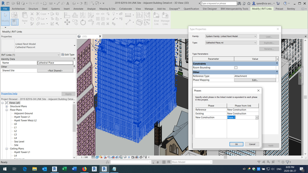

It can be achieved. First select the link and set the phasing map of the consultant model existing as their new construction. As well you must make sure there is a phase after that so you can change the new construction as phase 1.phase mapping.png
In the phase setting, set the surface pattern to white. Change the phase filter to show ALL. This will make the model white while the other one set in color.
If you want to override the material, you can click on the phase - exist and override the color to white.
