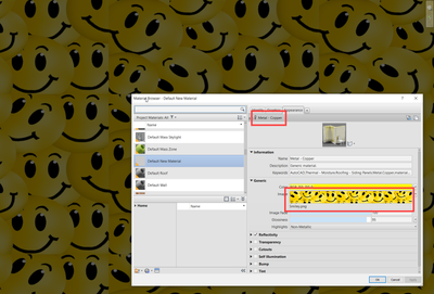

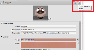

martijn_pater
Should work if you would just use a generic appearance asset. Or are you saying it somehow affects your physical/thermal material asset? That really shouldn't happen anyway...
Message 16 of 23
Creating a generic material from scratch requires the user to 1) add physical and thermal property tabs and 2) add accurate physical and thermal properties data manually. My design teams won’t do that, working quickly and on deadlines. For other types of materials I can duplicate and update the image. But Metals don’t let you update the appearance image.
Message 17 of 23
martijn_pater
Use and duplicate a generic type copper asset and then you can adjust the material image. That should work.
Appearance asset - generic typeAppearance asset - generic type
Duplicate appearance asset/adjust materialDuplicate appearance asset/adjust material
Message 18 of 23
