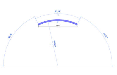

I'm trying to make a family with a curved window pane (no frames just yet - that will come later) that matches the curvature of the wall it is in via an instance parameter. I'd like to do two things:
1. The user manually matches the host wall radius with an instance parameter (unless it's possible to have a reporting parameter?)
2. The user sets the width of the window (not represented as a glass pane) which is a chord across the arc of the window. Because the window itself is supposed to sit at an inset from the outer wall edge the hole is larger at the outer radius and smaller at the inner radius of the wall relative to the stated width of the window.

should be able to use formulas for the arc lenght.
press the wall should look something like the picture .
50,09 is you arc angle (A)
4600 is your circle radious (R)
arc lenght= A*R
your Chord lenght is in the picture 3895
formula to use for this is
2 * pi * R
this should be your void Width
use R and A as instance value you write in the particular window since you need to take this value from the wall objects. the rest should just be math.
good site for understanding the math Arc Length Calculator (omnicalculator.com)
