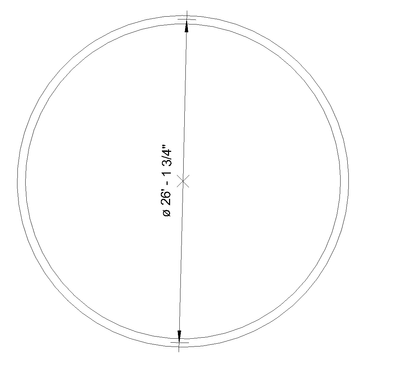

How can I dimension between two curved lines?
8 ANTWORTEN 8
Nachricht 2 von 9
RDAOU
als Antwort auf: sabamail65
Like this?
Dimensions strings need something to snap to...when lines are not parallel to lock on to their surface or axi, you would need to improvise a workaround. Example:
  • Use the Split tool to split the curved Line(s) or Wall(s) at the point(s) you need to measure to
  • Use tab to get the dimension string to snap to the end point(s) of the split segment

If you want the shortest distance between 2 arcs, turn on center and draw a line though, split the arcs as @RDAOU suggested at the intersection.  Then delete the line.

You can also place a shortest dim between to arcs without splitting.

Thanks for the previous answer. I had another question. What should I do if I want to measure between a curved line and a point or straight line?
Nachricht 7 von 9
mauricio_mssf
For aligned dimension, the tool always works perpendicular, in the case of a curve it goes to the tangent, so if you want to determine directions, just make an auxiliary line (I used a detail line) just to tell the tool the perpendicular direction, put the dimensions and then delete the auxiliary line.
If you want to use the arc length dimension, you need to select ther arq then the begin and the end, to say "i want dimension that arc, from here to there".
https://autode.sk/2Y5kSxn
Você achou esta postagem útil? Sinta-se à vontade para curtir esta postagem.
Ficou satisfeito com a resposta à sua pergunta? Nesse caso, clique no botão ACEITAR SOLUÇÃO.
 Mauricio Santos Filho Arquiteto | BIM Manager
Nachricht 8 von 9
Same method. Dimension from the center point the desired point or the line, then edit witness line to add the arc and remove the center point witness.
