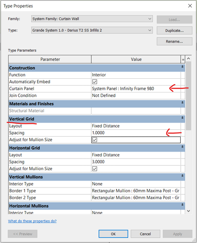

Hi all
I have made a curtain wall that is not displaying correctly. As in it is invisible until modified. This only happens with walls less than or the same as my fixed distance (3m). But I require this dimension to segment the mullions correctly. Which also have to be a multiple of three to correctly BOM.
Does anyone know whats going on?
Please have a look at the video attached to see what I'm referring to.
and the screenshot of its properties
PropertiesPropertiesof the properties.

You've placed a curtain wall inside a curtain wall as panel...
... don't really see why it wouldn't work though, if you edit the cw type, change&reapply the same panel it does work...
setting to none gives me: Changes have been made that cause a curtain wall with type driven grid lines to exceed the maximum allowed number of type driven lines (200 in direction (1) and 200 in direction (2)). If you really need this many type driven grid lines, please split the affected wall before proceeding.
Probably something to do with that...
Why not model it as 3 panels in a panel? or 3x generic model on array ie.

RDAOU
als Antwort auf: dariusA3K8S
@dariusA3K8S
It is not visible because you are creating only 1 instance which is =< than the specified fixed distance. Placing 2 instances or resizing will force Revit to regenerate …
Nonetheless, I do not get it why you are nesting a curtain wall as a panel?! You can simply set up the curtain wall to use the Infinity Frame 980 panel and the Vertical Grids at 1m fixed distance intervals...which would give you the same result without the above hassel

Nachricht 20 von 22
hmunsell
it has something to do with the panel being used. if you set the panel to Glass, it works fine.
