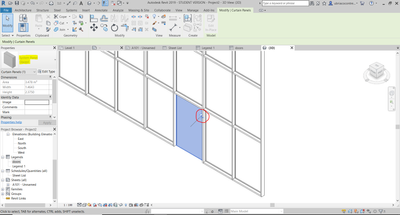

l wanna use curtain panel dowloand from web but ı dont know how to chance main material. l did insert the object but l cant find a any way bring my object.( intetnetten indirdiğim giydirme cephe malzemesini insert yaptığım halde içeriği değiştirmenin ya da bir duvard akullanma yolu bulamadım)

first load the panel in insert tab panel family editor load family
then select the panel if it's pinned you've to unpin (UP) the in the type selector choose your new panel in my case is a door
the click in edit type if the material option it's available only change the material.
this is the result
if you cannot change it select the panel and pick the edit family
Lastly select the panel and in properties pallete check the material if the panel has a parametric material only click in the type properties on the ribbon pallete and change in the correponding field

Thank you for your kindness but I follow the steps that u showed but first the object l inserted doesnt seems in the properties, after l try the change in edit ın-Place but at family types panles material and finishes has a only Finish horizontal :enttäuschtes_Gesicht: . I dont know how to use new Curtain panels in my projects. I take some pics for you maybe you can help me thank you have a nice a day

sorry for the late answer I'm in mexico, I have downloaded the file and I've just see that it's a kind of window I'll atatch a video link showing you how to insert it remember select the option place in workplane because its impossible by face.
Video https://autode.sk/2Ee5WCP
I've seen too the height cannot change in the project then the maximun height is 3 meters and It's really heavy the family. Please mark this post like the real solution if this were the solution.

Thank you for your helping. I didnt know that object was a window. :grinsendes_Gesicht_mit_Schweißperlen: Have nice a day
