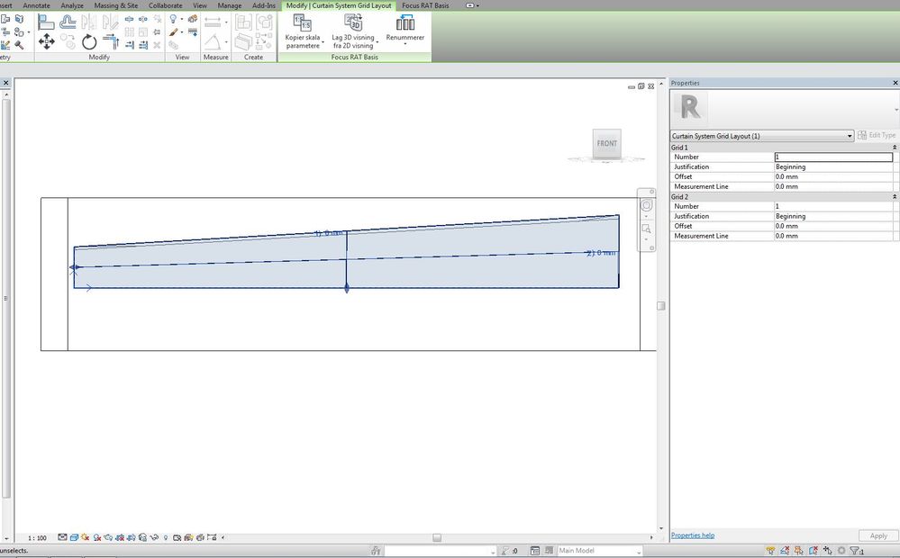

Hi
The last approach you describe is excactly what I did. I modellesd a mass and assigned a "curtain system" to the face of it.
Then I click on the curtain system and choose "Configure Grid layout" - (the little icon that shows up in the middle of the curtain system):
But I can't figure out, how I get to edit the orientation of the segments - as I mentioned, I want them to be horizontal. I can see you have the option to adjust the angle on yours, but somehow that function is not available to me.
What do I need to click on to get this option?

I just had a chance to open you attached file.  The face is slanted and that's why the horizontal grids don't respect the curtain system grid rule.  You may have to create a divided surface using intersects to define the horizontal grids (the first part of my first reply) unless someone can give you a better solution.

@Anonymous is right, on revit 2017 I couldn't solve this problem using your geometry.
But I found a solution (worked in my mind all night long)
Alright, basically you need the geometry to be perfectly planar.
So, in order to do that, I re-created an extrusion, then moved the top edge to create the slope.(1)
Finally, I substract a volume to make the height of the building skin variable as well.(2)
That way you garantee a perfectly planar surface
As you can see on the picture in light grey, when you create your curtain system, it works!
