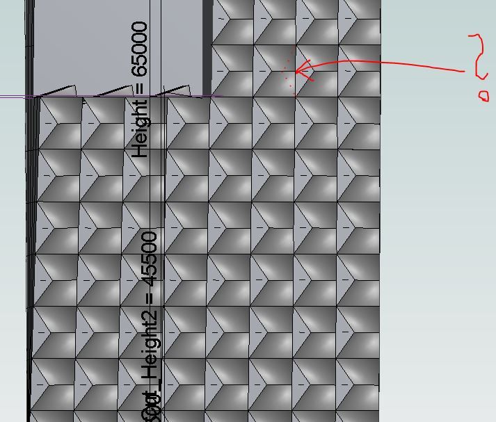

Hey,
I have created a parametric panel that I'm loading onto some faces of a generic tower.
On the vertical surfaces it is not loaded correctly, as one of the sides that's supposed to have a kink becomes aligned on one side of the rectangular pattern, in other words there should be an offset.
However on a planar surface it is shown correctly. I'm quite new to Revit, so perhaps there is an obvious answer to this one?
Have been stuck on this for a while and can't find any answer online, so would be super greatful for any advice!
Greetings from Oslo!
/Sophia
180403_Panel.JPG180403_Offset2 is not showing on this edge.JPG180403_On a horizontal surface Offset2 works.JPG

It seems the "offset"Reference line isn't locked in its place (see red line in tower family).
I haven't found a way to lock it and retain the correct direction.
You can build the family using a different approach, by placing points on points and giving them an offset.
  • Select workplane (of hostpoint) to determine the offset direction point_workplane.JPG
  • Place a reference point onto the face of the hostpoint point_placement.JPGpoint_on_point.JPG
  • If done correct, Revit gives a warning [There are identical points in the same place. Lines created from points may not work as expected.] just ignore it.
  • Give the newly placed point an offset, positive or negative. If you don't want negative offsets you can rotate the hostpoint 180 degrees.
See attached file that is fixed using this approach

Hey FAIR59,
Thank you for taking the time to have a look at it and explaining your method so thoroughly,
I agree that the solution is to build the family with a different approach as you say..
Kudos!
