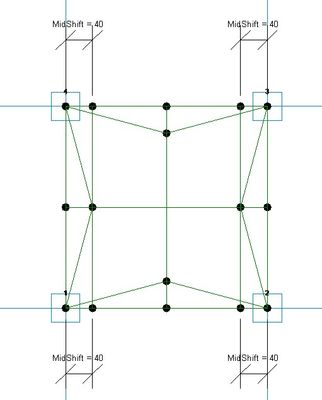

2. Curtain Panel family of a single "bowtie" unit.
Curtain Panel Bowtie UnitCurtain Panel Bowtie Unit
3. Conceptual Mass curtain wall with 2 Checkboard Pattern surfaces with Bowtie unit applied; one checkboard is indented and globally rotated 90 degrees.
Curtain Wall CheckboardsCurtain Wall Checkboards
While certain UV settings provide desirable results, many other settings lead to breakages within my single Bowtie unit family that seems to disregard predetermined length parameters and symmetries; the bowtie unit loses form in ways that I don't understand. I don't think I can move onto the attractor script until this has been resolved.

After messing around a bit more, i suspect the issue lies with the fact that my Curtain Panel family exceeds the rectangular boundaries of a single panel unit.
When I remodel the family such that it stays within the bounding box, i no longer run into the same issues of losing axial symmetry.
This works fine.This works fine.
Can anyone confirm this?

After messing around with the files a bit more, I think the original issue was that my sweep profile consisted of a closed loop within a closed loop. Once I fixed that, the family worked as intended.
