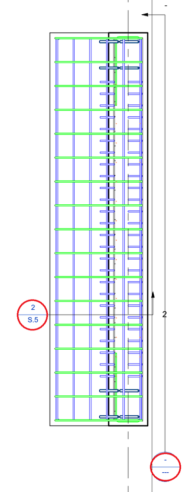

I'm experiencing problems with cross section symbols.
When scale is set to 1:50 cross sections do not show up?
When scale is set to 1:25 or less cross sections show up normally?
I had never experience issues like this before!
Revit version 2020.1
Regards!

check the Hide at scale coarser than option

@Alan.johnson1970
Thank you!
