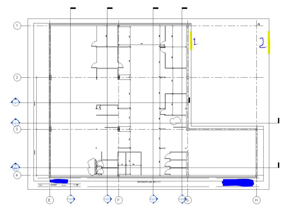

Hi all,
I have some problems with my grids and section lines. My crop view cuts out information like walls but the grids and section lines ignore the crop view.
Below I posted a print screen (I wiped out the logo and project name) marked the crop view by the number 1. and marked the paper size with a number 2.. It is a model made in Revit LT 2017.
Can somebody tell me how I could hide the grid and section lines that stick out of my crop view?
Thanks in advance.

for grid bubbles just right click and hide element. This will only affect this particular view.
For the sections click on the section and drag the section line edge to where you want it to end. again as long as you don't change the extent of the section line box the line should only change in this view.

Thanks, that helps a bit.
Do you also know how I can hide the part of the grid lines in the right top corner which sticks out of my crop and annotation view?
Same for the lines in my stamp below.

Hi!
For grids you can use two checkboxes like on a screen capture below. Another way to manipulate grids and levels is scope box.
But for section lines - just drag the end point as you want to..

Awesome, the scope box is the answer. Thanks!

same principal as the section lines - click on grid and you get a dot under the gridbubble and pull this down to bring the bubbles down into the sheet.
