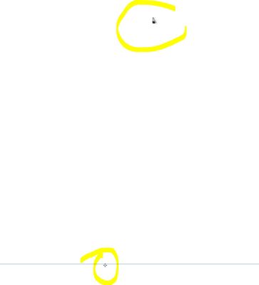

Hi, I am just new to forum.
When I am doing the elevations: east, north, south, west.
North elevations shows nothing even I try to enlarge the crop view to extra extra large. my visibility/graphics is on for objects I need. East elevations shows only elevations.
Some elevations (south, west) are showing the objects.
I am confused now. It there any way to crop/zoom to the object visible automatically?

First of: why are you working in Revit 2016?
Secondly: in the floor plan, your elevations are located in the bottom, but your builing is on the top. The north elevation isn't even looking at the import. Same for the east elevation.
You either move the import or move the elevations. Not just the lines, but the markers as well.
I suggest moving the import, it's currently located far away from the internal origin, which is located in the middle of the elevation markers.

Hi, It seems your elevations are located very far from your model, they are very close to the project base point, that is also far away from your model, probably the far clip does not reach your model so it won’t show up. You can move the elevations closer to your building or delete them and create new ones. I would do the last option because the elevations are still very raw and you will not lose much work.
