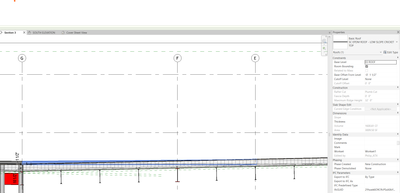

 RDAOU, I am attempting to join two separate roof assemblies, one for the shallow slope, and one for the "flat" cricketed roof atop.  My "flat" roof otherwise penetrates the deck where the slope of the deck runs uphill.
Attached is a scrn capture, which I have been resisting sharing.  (Caveat: the instructor is neither architect nor engineer, he inherited this direction set, and is editing the directions on the fly in an effort to introduce (and challenge us to apply) additional Revit drafting techniques.  There may be some egregious issues design-wise.)
The structural deck is essentially a very shallow "butterfly" type roof.  Roof drains will be internal to the parapet (no scuppers) at the low points of triangles on the selected (I'ma say) "West" end of the roof.
The "Cricket zone" won't join, thus this two-toned hot mess...
[Edited to add:  (I missed your other mssg,)  I wonder if the fact that I created the "cricket" assembly with a narrower layer of rigid insulation to keep it proud of the deck might be preventing the join?  I could imagine Revit sees two different roof types and says, "the heck you say, join these..."]

@RDAOUthe below video capture I tried does not show popups nor pulldowns (making it pretty useless and not informative, actually) but error message appears when I try to *JOIN* the two elements.  (It says "Can't *cut* joined elements" again as shown in earlier capture above.)
The elements are unpinned and detached, best I can tell.  They are both now of identical types/assemblies.
My assumption is that you used the "join" tool just as I did (err... tried to do) to make the offending excess below the deck go away.
Thanks.  I don't mean to be such a pain.  I don't know if I am being thick, or if my app is glitching...
