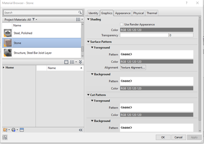

How do I create a stone masonry wall with interior and exterior layers of cement mortar? How should I edit the "Structure" or what "Materials" should I use?

if your referring to the structure of a wall
  • pick the Insert option
  • then Up/Down buttons to move the layer on ether side of the structural core.
  • from there, you can give the layer a Function and Material and Thickness.

like this?
If so, I think you've got it.  I'd say you have the right thickness. 300mm. And the right name for the Material. "Stone".
Go for it.
That help?
… "cement mortar as exterior layers":
Does 50mm sound about right?

Exactly what i was asking.  But i can't find the material "Mortar" in the material library.
Nachricht 5 von 5
als Antwort auf: Anonymous
Create a New Material and rename it Mortar. It's that simple.
