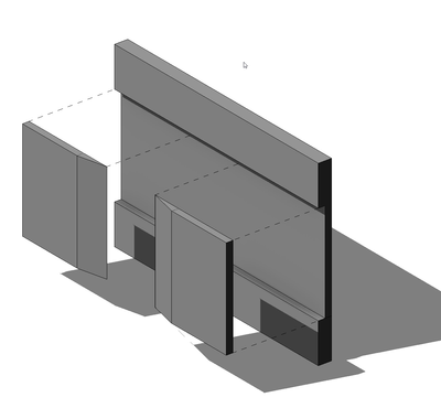

Hi there,
I've been trying to model the following image in Revit, I would like to create a wall family that is tapered in the plan not in the section, is that possible?

Join walls together

Nachricht 3 von 7
You choose model in place in home tab component button
Walls category
then draw the shape of tapered wall on the top while using extrude easy task on that track with the same shape you wish for
Accept my answer if it helps you

Choose wall category from model  inplace then create void with the same part you want to remove it completely
And so on you choose cut from modify panel and it will remove it from the main wall so you created void from model inplace to cut it  from the main wall as trick

@jihad.development wrote:
Thank you for your answer, What about the wall's layers then? Let's say I have an interior and exterior layers that I would like to keep the same thickness as the adjacent wall while changing the thickness of only the core layer
Think about how it will be constructed in the field and then model it in Revit the same exact same way.
