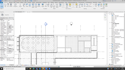

Hi! Still learning Revit and I have created a ceiling plan view within my project. I want to be able to see my floor plan while in that view to created different ceilings in each room. I edited the underlay to show my floor plan level 3 but there are extra lines that arent walls that I had created. I checked he visibility but I may be missing something. I have also attached a screenshot (my project is too big to upload )to show the difference between my floor plan and ceiling plan as I am confused. Hoping someone can help!

Yes, In range base level I set it to Level 3, then in range top level I put unbounded but I changed each of those options and nothing changed.

In this model I am in a Ceiling Plan for Floor 1 and want to see the layout below this ceiling so i set the following in the Underlay
This now shows everything below the Ceiling for this floor

@montesa3 wrote:
...there are extra lines that arent walls that I had created.
are there extra lines showing in your RCP or you're missing these extra lines that you created and want to see in the RCP?
