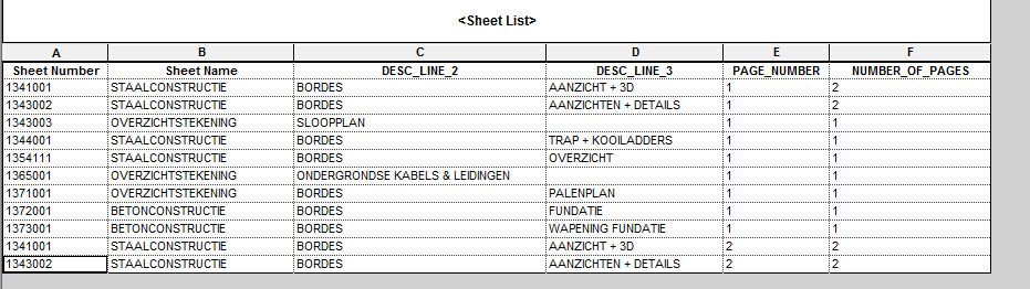

I'm trying to make a sheet list in Revit while using Unicode Control Characters.
We are using numbers like 1341001 as a "Sheet Number" (see attached screenshots), but we are also using a Sheet number multiple times in some cases, so there are multiple 1341001 numbers. In order to duplicate a Sheet Number we need to use Unicode Control Characters, such as LRM.
Our sheets contains of a Sheet number with a Page Number, for example:
1341001-0001
1341001-0002
When trying to make a sheet list a problem occurs. Unicode Control Characters are not recognized as a text nor a number, so if we try to sort the schedule by "Sheet Number", it fails to do so.. (see screenshot)
Is there any way to fix this problem?
I've tried different ways to sort the schedule (by Desc_line_3, by Page_number etc.), but none of those options worked.
Thanks in advance.

Would the possibility of using Sheet Project Parameters along with the Combine Parameter (Revit 2017) be able to suffice for what you are trying to do?
Have a look at THIS POST where I provided options/workarounds in Revit 2017 along with additional workarounds if you are using Revit 2016. (The Combine Parameters function was not available for sheet schedules in Revit 2016).
Let me know what you think.

Hi Rudi,
thank you!
I think that is exactly what we need in order to complete the auto generated sheet list!
I think we will have to combine the sheet number parameter with the page number parameter to fix the problem.
The workaround you mentioned in your post is something i already tried and works for now. But we were searching for an automatic sheet list.
unfortunately we don't use the 2017 version yet. If everything goes according to plan we will start using Revit 2018 in April/May. Hope the combine parameter function is still there in 2018.
