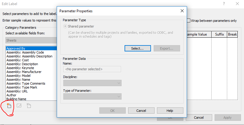

hi @Anonymous,
The good news is that shared parameters DO work with sheets!
What you need to do is simple:
-create your shared parameter
-in your title block, create a label, and then  click on the "create" icon at the bottom left of the pop-up window, pick shared parameter and go get it! (cf picture)
-load the family into your project
-add the shared parameter to your sheet category via the project parameters window
You can the enter the parameter into your sheet property panel and it will display as any other label in your titleblock!!
Cheers,
François
