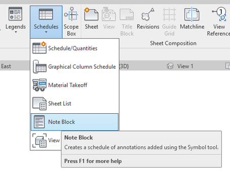

I Found this file online that has a schedule for Generic annotation but i could create one in a new project.
How are these Custom Categories added/created

You can not. The type of schedules are hardcoded.
The generic annotations schedule can be found when creating a note block schedule.
