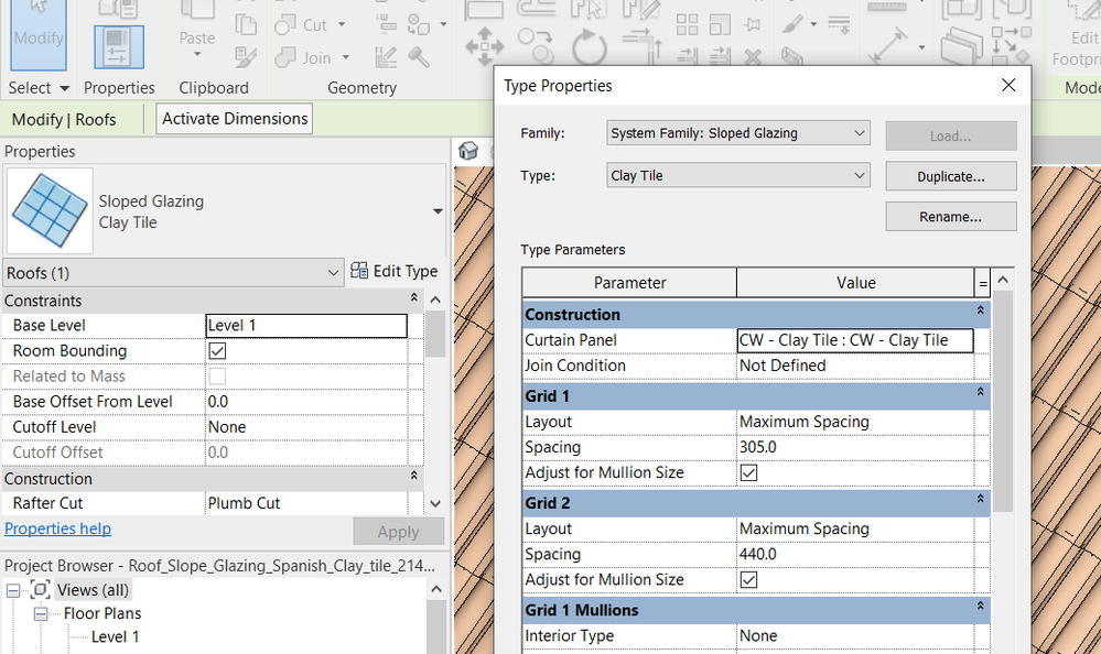

als Antwort auf: syman2000
that is what im trying to archieve, do you know how i could make that concrete tile file be used for sloped glazing?
Nachricht 6 von 25
syman2000
als Antwort auf: Anonymous
In the family, I check on Workplane base and check off always vertical. This means the family can be hosted to reference plan or surface. In the curtainwall, you make the tile host vertically so it will able to host to slope glazing.
Nachricht 7 von 25
How did you get that menu to pop up? mine looks different.
Nachricht 8 von 25
martijn_pater
"In the family", select the tile, click edit family above, adjust and load back into the project.
Nachricht 9 von 25
syman2000
Your is in project environment. Mine is in family editor. To get the tile to work with slope glazing, you have to placed the 3d inside the family.

Nachricht 12 von 25
syman2000
Just insert your 3d model profile into curtainwall panel family template. Make sure you go to elevation and place it in there.
Load it in to your project. Create a curtainwall type and add in your tile spacing and make set the tile as your curtain panel. Check the sample file I've provided.

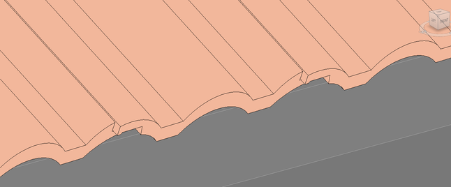

Nachricht 13 von 25
hi all,
Took a while but ive finally managed to add it to the project by creating a mass object and dividing the surface (is this method slower than using sloped glazing?)
but i cannot get the tiles to stack on top of each other cleanly, ive tried to angle the tile at 2 degrees in the family template but it still doesnt sit correctly.
What is the best way to do this?

Nachricht 15 von 25
i understand the concept now, thanks syman2000
Just one last question, how do i edit your tile within that project? the tiles are not stacked properly width wise so ive assumed i have to edit the grid width in the tile family template?

Nachricht 17 von 25
syman2000
If you want overlap, let assume your tile is 440mm and your overlap gap is 20mm, then your adaptive grid would be 420mm instead of 440mm.
Nachricht 18 von 25
yeah ive figured that out playing with the grid spacing but the tile isnt lined up properly, is there a way to get back into the tile family and readjust it? i think i may have placed the tile incorrectly unless theres another way to do this
Nachricht 19 von 25
syman2000
In the adaptive family, you have to add midpoint line and then lock the panel to the mid point line.
Result will align the panel as straight. See attached
