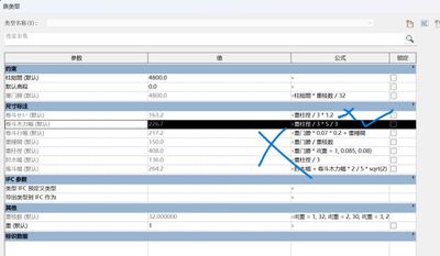

heichan88
als Antwort auf: ToanDN
hello @ToanDN
no, there is no parameter in the txt file, i now created a blank new txt file, nothing inside, please see the screenshot
