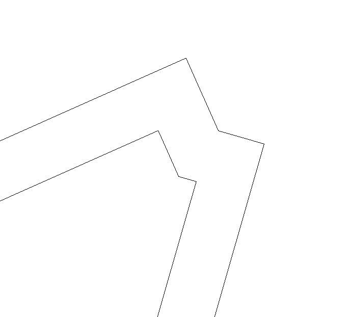

Hello! Can someone can help out with this isuee what you see in picture. How to create walls whats not by basic parameters. In picture I have dwg picture from autocad and i create things on top of it.

hello, you can try model in-place > walls > extrusion. thanks

i need to connect both walls i dont find such a option extrude

You can make a wall extrusion in place and afterwards modify>join.

I don't really see what your issue is? I was able to recreate what you were looking for just using basic wall types and using the disallow join command and then rejoining elements using the join tool.

I agree with @ennujozlagam - the approach with creating an in-place wall drawing extrusion shape on the floor plan and extruding the wall upwards seems to be the right approach to me.
I´ve just made a video for you to show how to model the geometry with 2 normal walls and an in-place mass wall and how to have the geometry as one single peace of an in-place mass extrusion wall.
