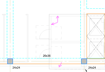

I have our Structural consultants Revit file linked into ours. I want to filter out their walls except the foundation, which is a basic wall type like all the rest. How can I filter out selected walls from a linked file?

Depending on whether the Linked structural Model is a workshared model or not...I would filter them similar to the below:
  1. Ensure Link visibility is set to Custom/ Linked View by Link and Filter by Host
  2. Check the Workset name which the walls in the Link are using
  3. Add a Filter
    • WOrkset - contains - ex: say "Structural"
    • Type Name - does not contain - Foundation
    • Add filter to the view and uncheck Visible
Would look like below GIF (Results may differ depending on the set up of your Linked model
kjskoog
The main issue I had was the linked Structural model had only one workset. I did use your way to get the result I needed with some minor adjustments but it was a good starting point. Thank you!
