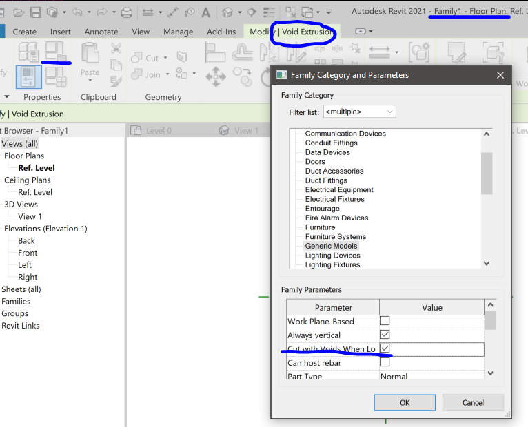

I need to model elements that are embedded inside the floor/slab, but these elements must cut or create a void in the slab/floor. I can't use the shaft option, because I need to also make a count of these elements. I have attached pictures of the floor plan and section.

You've got a few options, but the key things are...
1. Make a void in the family
2. In the family, open 'Family Category & Parameters' (the folder icon on the create toolbar) & make the family cut with voids.
3.When you've loaded the family, 'Cut' the family from the floor (click the floor, then the family)
I've added a gif to walk you through, under the images.
Hope that helps,
Mark
