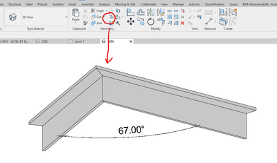

I'd like to draw beams with a cornice. When the angl between two beams is >= 90°, it works well. But when the angle is < 90°, the join is incorrect.
Could you help me with this issue ?

Use Miter tool.

Besides the Wall Join Tool, you can also cut back to a Ref. Plane.
https://revitiq.com/mitered-beam-joints/
