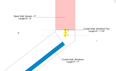

I'm currently working on modelling an existing building with a number of unique corner conditions for mullions and interior storefront walls, i was wondering if there's a good or reliable way to model this type of mullion join condition:
The nearest i would assume i could get would be to use two different storefront walls and use one of the corner mullion types on the join, and make the second wall very, very short, but i feel like that isn't the correct or proper way to make it, and would be very buggy. Is there a better way to make this type of corner mullion, especially for buildings with lots of strange and unconventional angles?

@mbootsUJVFW wrote:
...very, very short, but i feel like that isn't the correct or proper way to make it...
Seems "correct" and "proper" to me.  That's the way I'd roll.  In this screenshot example, I end up with a tiny 1/16-inch extension. That's probably closer to the real life condition of the fabricated aluminum mullion than 0-inches would be.   :zwinkerndes_Gesicht:

No, this isn't correct... I'm not trying to join two different curtain walls, it's a curtain wall connecting to a standard wall. Hence, using corner mullions for the curtain wall doesn't work because the other wall isn't a curtain wall, and so the corners default to a 90° angle since there's no adjoining curtain wall.
I've considered in certain cases just making the other wall a curtain wall as well, but with no mullions and using the correct wall type as a panel instead, but I feel it might run into bugs with that method and lose functionality in other aspects.

Is that a storefront wall connected to a standard wall, or a curtain wall connected to a curtain wall with a standard wall as its panel type? because every time i try to connect a storefront to a standard wall and change the mullion to a corner mullion, i get this error message:

Does this screenshot help?
