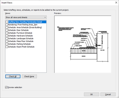

You can save Drafting Views out of Revit and reimport them into new Revit projects as this was an intended workflow
Select a drafting view in the Project Browser. Right-click the view name, and click Save to New File. Enter a new name for the project. This creates a new Revit project file that contains the selected view and the contents of that view.
This can also be done for all views at once from a Project - File Tab > Save As > Library > View
You can also Import directly into a New Project from and Existing file - Insert Tab > Load From Library Panel > Insert From File > Select File > Pick View to Insert
