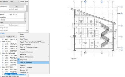

syman2000
Only way to save the model with annotation is to right click on the view and save it to new file
Afterward you can link in the model, create section and link by view and select the link by view.
