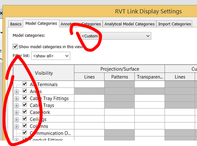

this is my way to use information from linked model:
i like it because i can use current view timplate, filtres from my projects etc..

Thank you @Stanis-74, and this would allow me to be able to turn off the linked model but still be able to see the referenced portion of the link in my plan view?
Nachricht 4 von 9
Stanis-74
als Antwort auf: Anonymous
No))
