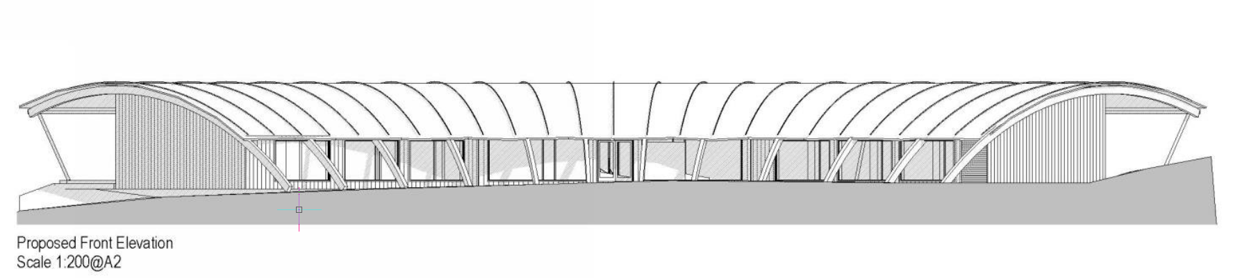

Hi all,
Before I embark on many hours of pain. Is the attached roof design possible in REVIT without dynamo?
Thanks in advance.

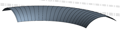

Yes, as an in place family...I used a sweep for the roof and an extrusion for the standing seam which was them mirrored to other places along the roof.roof elevation.pngRoof.png

- Create a mass: draw a curve for for the sweep path and a curve for the roof profile then create form
- Divide the form surface and set UV to match your standing seam spacing
- Create a roof by face by picking the mass form surface
- Place structural framing by picking the divided surface lines for standing seams
