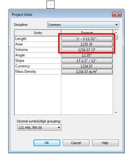

You can change the Project units for the meantime while you were working.
Just go to Manage Tab > Settings Panel > Project Units.

Got it!.. Thanks a lot..
