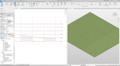

Contour lines not appearing under a certain level
contour lines do not appear under the ground floor level for some reason, in all views...
Thanks!
1 ANTWORT 1
Nachricht 2 von 2
topo settings probably are set to stop (or start) displaying contours at a certain level
https://knowledge.autodesk.com/support/revit/learn-explore/caas/CloudHelp/cloudhelp/2020/ENU/Revit-M...
