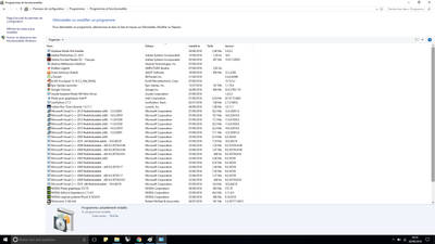

Yes as indicateded in one of the autodesk help page for clean uninstall I cleaned my register.
I also tried Microsoft clean up as you indicate, and just tried the IObit uninstall tool, There is no content library on my computer according to it. (see below) Relaunched the installation just to check : still telling me the content lib is installed.

RDAOU
als Antwort auf: Anonymous
@Anonymous
Looking at your control panel "programs & features" you have Akamai Netsession client installed ... Means you have been trying to install directly from AUTODESK website.
Instead, go to AUTODESK Virtual Agent website and download the 2 parts installation files from there. Extract and download (download should start automatically after extract is complete)
before you do that
  1. Uninstall the Akamai Netsession Client
  2. clear the temp folder (type %TEMP% in Windows start menu search/run command bar... Then delete all what is in that folder)
  3. disable any antivirus and firewall you have
