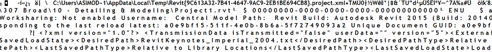

Pulled the basic info from your current Revit, still waiting on Revit 2017 trial download. Smiley (traurig)
Nachricht 9 von 13
wispoxy
als Antwort auf: Anonymous
Nachricht 10 von 13
wispoxy
Good news and bad news.
The file in general is fine, an external reference is bad. So I'm trying to isolate the individual references, but Autodesk doesn't have an external reference manager like the one that comes with AutoCAD.
Your references as listed:
*307 BROAD RESIDENTIAL - ARCH - TB.rvt
*307 BROAD RESIDENTIAL - SHOR - TB.rvt
*307 UG_UT.rvt <--- I believe this one is the issue.
After isolation you would receive the working eternal files individually, and the broken one excluded. Allowing a good portion of the project to be recovered. If someone else could help me achieve this, it would be awesome.
Noticed a system date var. defaulted also. Which is most common when people are working on projects off corporate servers and managing external references, but not in all cases.
Being the fact I don't have an external reference manager, the task will take me a very long time. I'll continue working on it.
