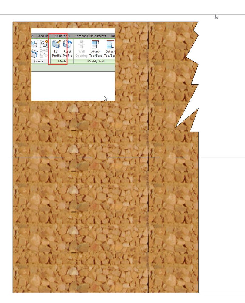

But what i mean is then when you connect 2 walls together the edge is perfectly drawn as a line which isn't realistic in the case of my architecture here... and that is what i want to change.
To not have such neat edges to create a more hand made feeling... don't know if my explanation is being clear, but le me know it it's not.

Ahh I get what you mean now... You can edit a wall edge from a section or elevation view using 'Edit Profile" with the wall selected.  This will put the wall into 'sketch' mode and you can draw whatever edges you want.  I just hacked some teeth into this wall, but you could take the time to trace out the stone edges and make it really cool.

But my concern would be then do i need to edit every single wall to obtain that or is there a way i could do it in mass or something?

I've seen some Dynamo scripts people have built that generate rubble walls by creating random shaped "stones" and applying them along a given path and height, but I have no idea how you'd do that without pushing into Dynamo.  I don't have much experience playing with Masses since I work for construction companies.  Every thing we need is, for the most part, rigidly designed.
