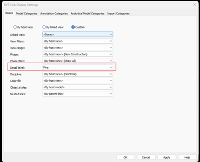

There are several ways to do it.
1. You may go to visibility override option and then change them to Fine. Keep your views withMedium/Coarse.
 2. You may create a separate model for conduit and make that view in Fine and link it into the working model where the DL is set as Medium/Coarse. Now you can go to the visibility override option and then to Revit Links. Select the link and change the display settings to custom.
Then change the detail level to Fine.

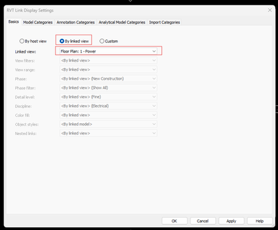

3. Select By Linked View option and choose the floor plan you want to show from the drop down options.
Hope this will help you.
