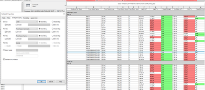

My problems is I can't seem to use conditional formatting on totalled values when sorted or grouped by.
My goal is to have grouped total values for the column Ventilation to be what's used in the formula not the singular item
fig1
shows varies and formatting settings don't let you total for formulas.

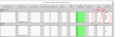

fig2
shows the formula I'm using

You're problem is with the that the cell shows <Varies> and not True or Fail value?
How it the formula "if(vent % > 0.05, "True", "Fail")" supposed to work, does each item have to pass it or does the grouped value (Sum) need to pass the value.
Calculations take place on item level and with grouping just the results are compacted depending on grouping fields.
So values of "True", "True" and "Fail" result in "<Varies>", and then conditional formatting doesn't work.
